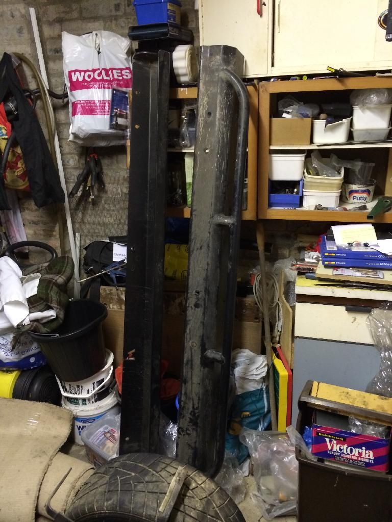

That was the end of issues and such till the summer, when i finally managed to get myself a Expedition roof rack for the car.
That was a bit of a faff trying to get fitted as it came with none of the 6 mounting brackets needed to bolt to the roof.
So, i had them made up from drawings by guys in the SLROC and with some light tweaking they fitted and one rack was bolted on.

Step forward a month and ebay delivered a proper Prospeed rear ladder for the car. £210 brand new. Mine delivered for £102.
I did have some issues with fitting and after a few calls and emails Prospeed delivered another mounting kit for the ladder. I've had no issues with the ladder since.

So, the mot is near and it's finally time to fit all the bits i've been buying and storing ready for it.
We have the following.
2x RRS front lower arms. These have a larger ball joint and also better bushes.
4x rear hub bushes. Forgot to change these when i spent the 2 grand on suspension so it's time to sort them
1x drop link. For some reason, the front right one has failed again so getting it changed.
2x inner steering arms.
Bolts and fixings just in case any don't want to come out, even though all the bolts needed to be removed have been copper slipped in the last 2 years.
Then it's a 4 wheel alignment and then mot.
Also, due to spotting a possible bargain.
I have bought the following.
1 Mantec winch version sump guard. These are the guards fitted to the 06 and 09 G4 Discovery 3's so decent bit's of kit.
1 external winch mount.
This is the winch mount, with a Warn winch fitted. This D3 is also wearing the A bar and spot's i have fitted to mine. So it's a decent comparison and shows how the mount will sit. I will have to cut the bumper and also remove 2 inner parking sensors and also disable the front system.
This is the sump guard, with extra slots for the winch mount. Picture is of the 06 G4 competition in Bolivia. Yes, i've done worse off roading before anyone says... ;)
The beauty of this was that i sold the RLD guard for what i paid for it 2 years ago. I also sold the very well used old RRS wheels off so this upgrade is costing a whole £65.. :mrgreen:
Mount will go in the loft till i can find a decent winch for the D3. It's heavy and so needs a 9500 winch at minimum. I'm going to go for a 12,000 one for true peace of mind. However, that will be expensive so it's for a future date.
