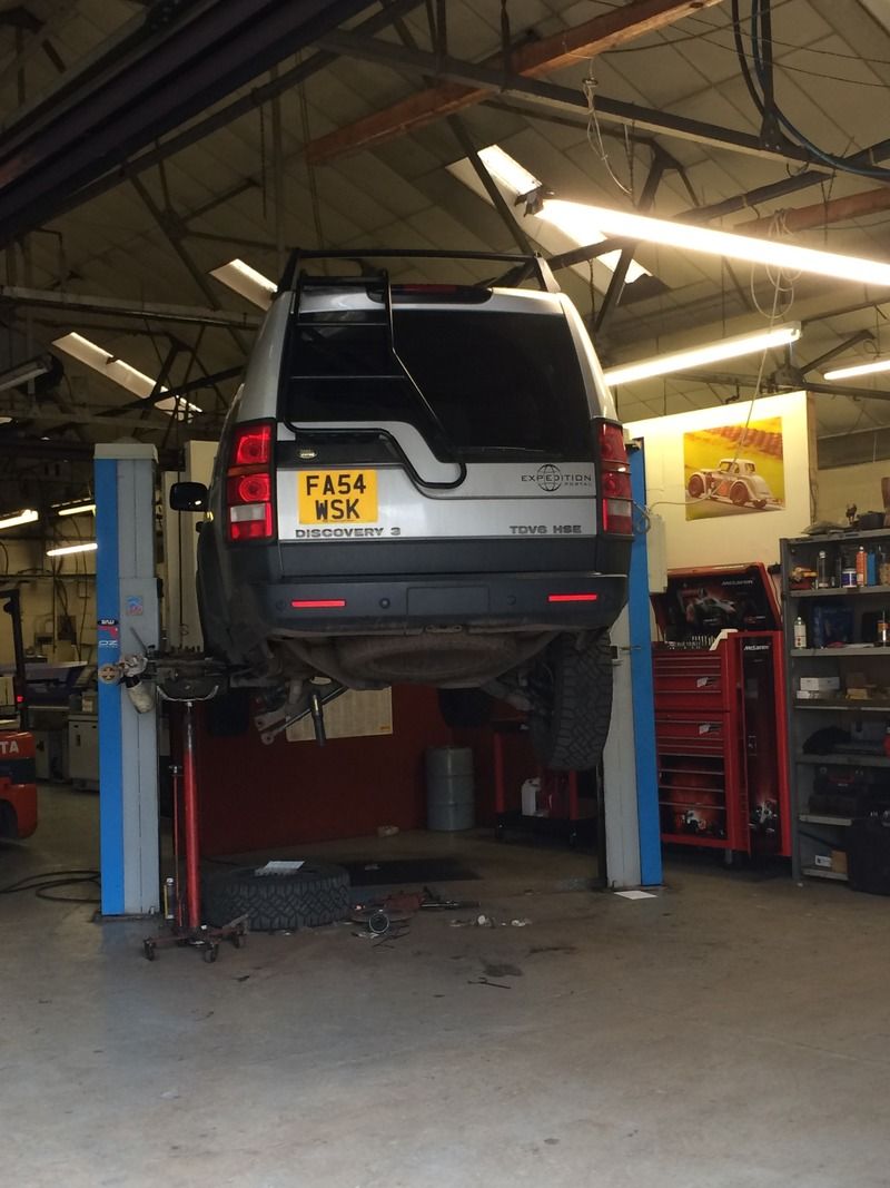

Car went into local garage to get a few items done as i had a couple of days off work and sometimes it's better to let someone else get all dirty, annoyed and fed up with the car.
So. The following were changed. 4x rear hub bushes, these have been squeaking for a while and finally are done. No more noise from the suspension over bumps etc. 2 gaiters had to be changed due to small cuts. 1 cv joint.
The cv joint i could hear clicking away while off roading, it would sound when i had the car leaning over to the right extending the rear left side out which is where the joint was.

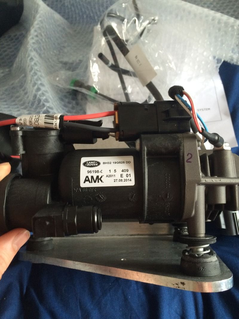

This is the long overdue replacement for my air suspension compressor.
The D3 uses a compressor called the "Hitachi" model. It is fitted to all D3 models from 04-09, all RRS models from 05-09.
It basically is a pump that pressurises the system to 120 psi. This goes to the air reservior tank that is located under the left side sill. The reserviour then sends the air under pressure to the front and rear valve blocks. These then split the air left/right to each corner for the suspension bag.
The unit has a few weak points, these include the inlet/outlet pipe cover cracking between the pipes. The air dryer clogging up/silicone gel breaking down over time. The pump piston seal leaking, the piston conrod snapping and the unit being damaged due to an incompetent garage, recovery driver or owner mistaking it for the chassis hole and rear left jacking point.
The unit has a life of 5-6 years but they have failed way less than that, or have ran way longer than that. It is luck of the draw. It's also largely to blame for the D3's slightly unfair reputation for unreliable suspension problems.
The "AMK" unit works the same. It is slightly larger than the "Hitachi" has better dampers and the 3 bolt holes and bolts to mount to the chassis are better designed. The AMK is fitted to almost all Disco 4 models, MY10+ RRS models and is proving to be far better in terms of being reliable and having a longer life. There have been a few noted failures but the rates are WAY lower than the Hitachi unit.
The other bonus is that the AMK needs the pipe work modified to fit. So i will need to cut the pipes, which neatly side steps the issue that my inlet and outlet pipes are seized to the Hitachi and won't come out.. It also comes with a whole new protective cover, pipework, new relay and will require a software update to run properly.

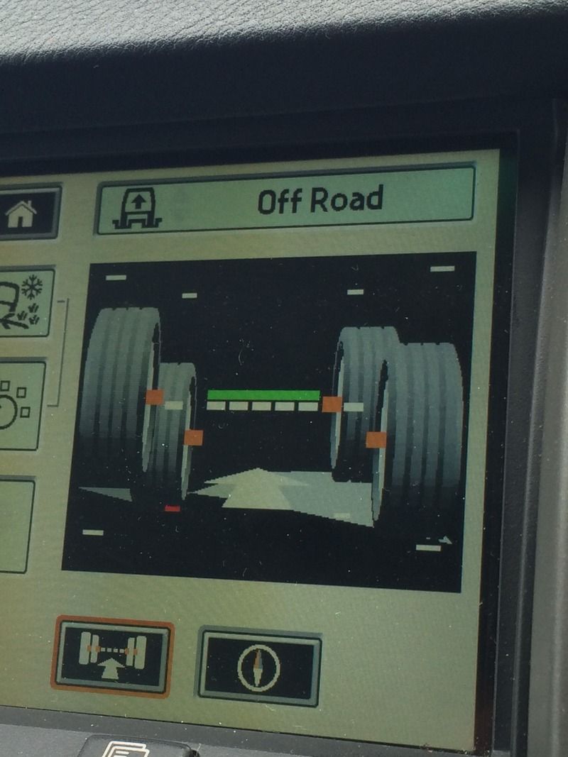

This is the off road screen, it doubles as the built in sat nav which is standard in SE and HSE spec models.
This lets you know about the following bits while off roading.
If you are in high or low range.
If HDC is on/off.
The suspension height, access, normal, off road, extended, super extended.
The Terrain response setting if selected. Grass gravel and snow, mud and ruts, sand, rock crawl. These alter the throttle response, the way the traction control works, how the centre and if fitted the rear locking diff works etc.
The steering angle, it will show which way the front wheels are pointing from left to right.
The 4 corners and heights for them.
The green line is the centre line, each corner will go up/down depending on terrain. If there is a red line under the wheel. It's because that wheel is lifted off the ground.
It's a very handy guide and helps with getting the most out of the car for off road use.

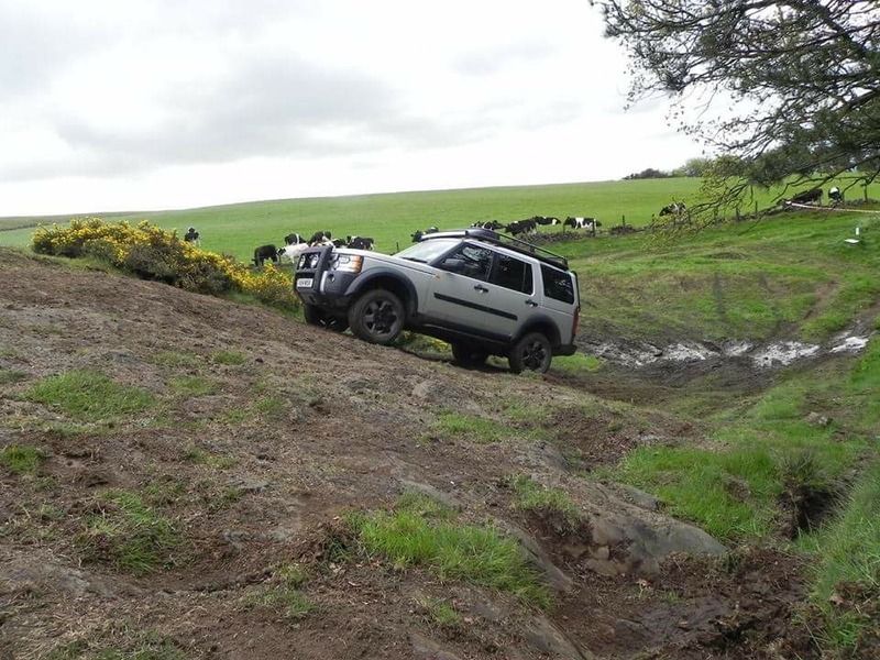

The best way to drive it off road is smoothly and with gentle steady throttle movements.
You can't off road them like a old Defender etc. It's a different beast and needs a different way of thinking to fully get the best from it.
You have to work with the car with smooth throttle inputs and let it work out what it want's to do.
They are highly effective though and can walk up silly steep slopes that the older models need to carry serious momentum into getting up.

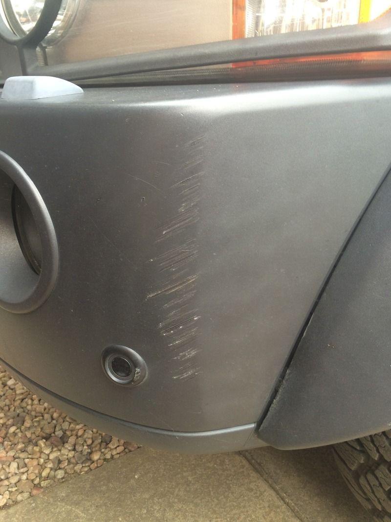

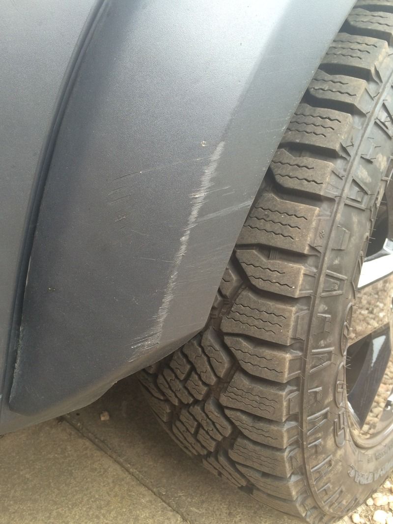

Someone very kindly hit the car in Glasgow Fort and drove off without leaving a note.
The damage is to the front arch and also to the bumper. I'm not claiming on the insurance so will eventually have to find and refit new bumper and arches.

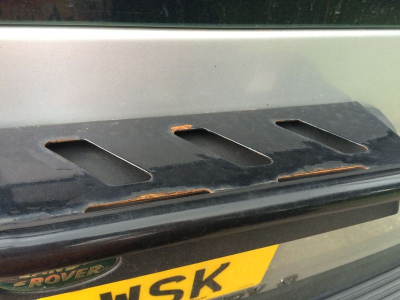

The rear ladder is rusting where the powder coating has broken and lifted. Asking on the Disco3 forum, it's far from an isolated case.
It's going to a company in Lanark soon to be cleaned, stripped and recoated. They have a 5 year minimum warranty on the work.

Old pump was removed by cutting the 2 pipes and unbolting a pipe off the middle valve block for the suspension.
This shows the difference in the new AMK vs the old hitachi unit.
Another comparison between the old and new.

Now. When the covers were fitted and the AMK software updated on the car via the iid tool. It threw up a problem.
Not what you want to have when you've finished the build, luckily it just needed a re enable of the EAS system. New pump turned on and started to reflate and pressurise the system.
Car slowly rose back up to normal height and I left it to idle for a while to let the new pump have the system fully sorted.

Postby Andrew[MG] » Tue Dec 08, 2015 11:56 am
Good work on the pump upgrade!
What's the treat you're getting it?
