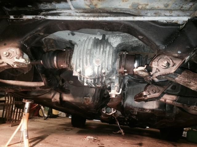

So the car's been on the road for a week or so now, and the welded diff was a nightmare to live with. So I went to pick one up yesterday in Tranent which gave the car its first longish run in my possession. Everything seems to be all good, apart from the fact I hit a dead badger on the road which ripped a sensor out the exhaust so the car made an awful racket on the way home.
So today I set about doing the diff and a couple of other wee jobs inbetween. I love working on import cars, only encountered one seized bolt and I managed to get round taking that one out anyway.
Here's how the day started. You can see the dangling sensor on the cat too.

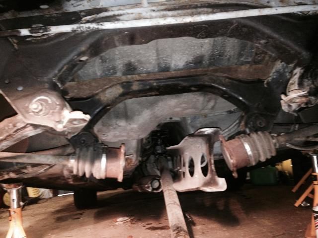

Removal involves both driveshafts and the propshaft, then 3 long bolts on the central frame and 3 each side holding the diff to the chassis, all came out easy enough with the exception of the final bolt on the prop being rounded which meant I couldn't hold it still while removing. The solution was to tied the prop to the frame and remove that way. Bingo!
And with that the diff was out!

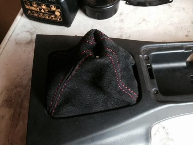

After I got it out I had some lunch and did some of the easier jobs I had lined up for the day. Replacing the gear shift gaiter, shifter boots and seat belt stalks which the gent who sold me the diff kindly gifted me after I told him I needed some.
